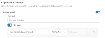

For some reason, when I used to set up my search configurations in map viewer, I was able to see ALL of my layers in the map.
Now, I am only able to see rest services that are non editable. So, all of my features that I have published with editing and query capabilities are not showing up as a layer for me to choose under the search configurations. This is breaking all of my search configs that I had previously set!

EmilyGeo
Hi @LISARAYBURGodot
Are you trying to set up search by layer for hosted features services in Online?
As long as the layer contains fields that are either text or integer and do not have a coded domain, it should work:
LISARAYBURGodot
They are rest services. They are text fields and they do not have a domain assigned to them. The layers aren't even available to pick from the drop down list.

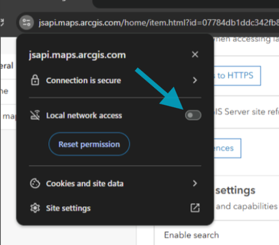

EmilyGeo
Hi @LISARAYBURGodot, It sounds like the services are getting filtered out for some reason. Are you using Chrome? A recent chrome update might have reset the permissions. can you check to make sure this is toggled on?

EmilyGeo
Hi @LISARAYBURGodot
I'm still not able to see the issue on my end.
Are you using Edge 143? If so, it could still be re;ated security issue from the chome update since its used in the backend.
