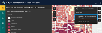

It looks like there is an invalid locator in your app, do you know if a locator has been added to your organization Geocoding in utility services recently? Can you try deleting it in the search section of the app configuration and see if that allows the app to load?

Alternatively if you are an org administrator you can remove it from the Geocode area of the organization settings in ArcGIS Online

Thanks Kelly, I will see what I can do about that locator.
My app is loading for me now even though, which is great. I'm not sure what was causing it to freeze. Oh well.

@NealHicks we pushed a fix the other night so it'll work now even with the invalid locator
