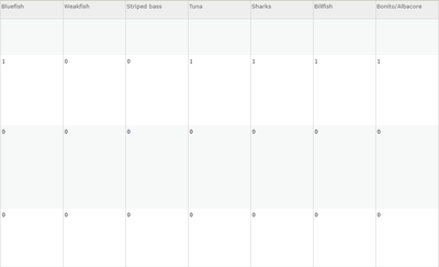

Hello,
I'm trying to use Arcade to return the field aliases of fields that have a value of "1" in the data. I have a table of fish species and I would like to return the field alias in the popup anytime there is a value of "1" found in the species record (image of table below). I currently have an Arcade expression that returns all of the field aliases if a "1" is found in the data, but I would like to specify the fields to return.

Example of the data table:

You can specify the fields returned for the Schema array using
var fields = ['SUMMFLOUND', 'SEABASSTAU', 'CODPOLLOCK', 'BLUEFISH', 'WEAKFISH', 'STRIPEDBAS', 'TUNA', 'SHARKS', 'BILLFISH', 'BONITOALBA', 'SCUP', 'RED_HAKE', 'LOBSTER'];
var features = FeatureSetByName($map, 'Ocean Prime Fishing Grounds', fields, false);
Now this will also include the OBJECTID field, so you can test for that when looping through them
if (dict['name'] == i && dict['name'] != 'OBJECTID'){
