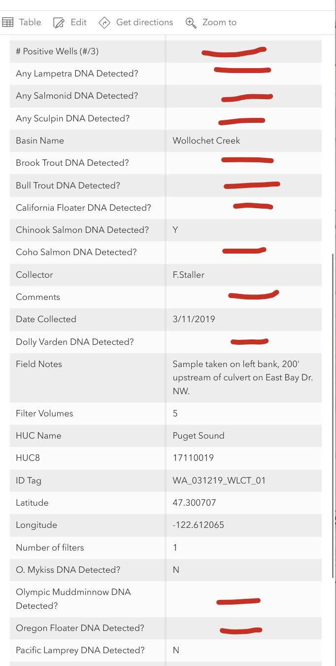

I am making an online experience and need help with Pop-ups
I have a point layer that contains my company's environmental DNA sample results. There are over 1000 data points, containing information on over 20 species. The point attributes include 46 fields.
When a point is selected in the map, I would like the viewer to only see those fields in the pop-up window that have data for that particular point, instead of having to scroll through 46 fields to find the pertinent DNA results.
For example,
For this point, I would like the following pop-up window to omit all the empty rows (red slashes).
Can someone help me with this appropriate arcade expression?
I prefer the default pop-up look. No fancy headings or color are needed.
If you could provide an example that would be great!

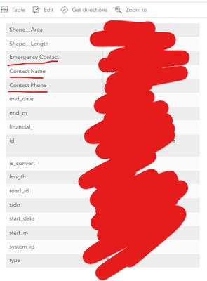

Also, if it were possible to have the resulting popups use the display name instead of the field name, that would be amazing!
gis_KIWI4
MVP Regular Contributor
Here is the code to use display names -

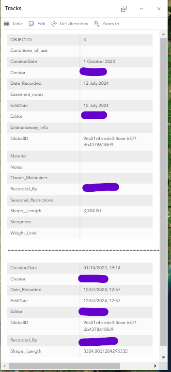

WFCAdmin
Thank you gis_KIWI4!
So here is the issue that I am having.
If I simply have my title and the arcade expression I get only the title in the pop-up.
If I have the title, the field list with all 46 fields checked on, and the arcade expression, I get the full list followed by the abbreviated list. The abbreviated list works perfectly this way always filtering out the empty fields, but it defeats the purpose because the pop-up is still clogged with a bunch of blank data to scroll through.
Any suggestions?
If on the other hand I add a fields list below the arcade expression I get
