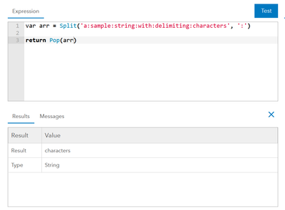

jcarlson
MVP Alum
You can do this pretty simply with Pop, which will return the last item in an array, regardless of its length.
var arr = Split($feature.StaffComments, ":");
return Pop(arr)
- Josh Carlson

jcarlson
MVP Alum
return Pop(arr)
- Josh Carlson
Kendall County GIS

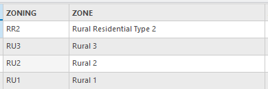

SarahHartholt
I'm trying to use the Pop method to return "Environmental Protection" in my pop-up but instead it returns "EP". Can someone please let me know why the text before the dash is being returned?
KenBuja
MVP Esteemed Contributor
Are you using domains for this field? If so, you'd have to use DomainCode inside the Split function.
SarahHartholt
Thanks for bringing that to my attention! I made a copy of my original data and shared that as a web layer to AGO. The original data contains coded values and unfortunately the copy did not write the text to my new field as I assumed it had. So as it stands there is nothing in the field to split. My plan is to use a series of if statements to populate the data I need unless there is a simpler way.
