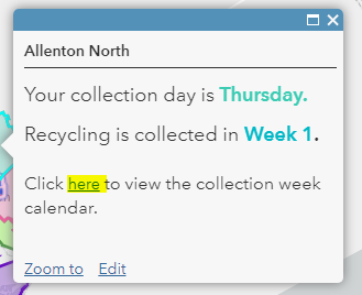

I am trying to embed a URL into my pop-ups for a rubbish collection map.
If the collection week of a boundary is week one, I want the URL to go to the week one page.
If the collection week of a boundary is week two, I want the URL to go to the week two page.
I would like the URL to be embed into the word "here" in the pop-up as seen below:

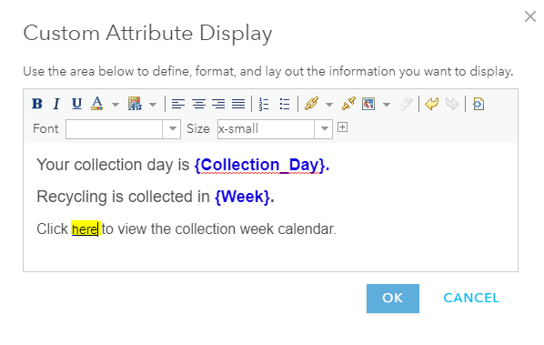

You'll want to add the Arcade as an attribute expression, and then point the hyperlink to that expression. It looks like you're using Map Viewer Classic, so that button is here:
Once you're there, try adding this expression:
var week = $feature.Week
decode(week, "Week 1", "https://www.ashburtondc.govt.nz/?a=57072", "Week 2", "https://www.ashburtondc.govt.nz/?a=57073")
Then, with "here" selected in your popup configuration, click Link and enter the name of your attribute expression in brackets, like this:
Click 'Update.'

The pop-up has recognised the word "here" as a hyperlink in the pop-up however it does not navigate to anywhere/can't be clicked. Am I missing something here? Thanks!
