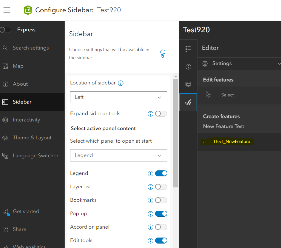

Hello,
I am working for the first time in Instant Apps - Sidebar (option) for a public to input (add) a location in a map. My question is how I can rename "TEST_NewFeature" highlighted in the screenshot below to a 'New Feature"? I tried everything to rename the layer in the Web map but didn't work.
Thanks in advance.

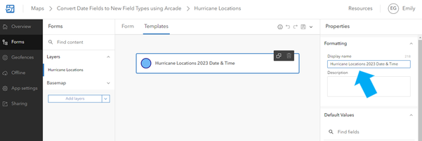

Hi @Almaz_Naizghi
It looks like Test_NewFeature is the name of the template.
You can rename the template in Field Maps Designer.
  1. Open the map in Field Maps Designer.
  2. Navigate to the layer
  3. Tap to open the 'Templates' tab
  4. Select the template
  5. Change the display name and save changes.

Almaz_Naizghi
Thank you! It worked, I am glad I finally posted my question here.
