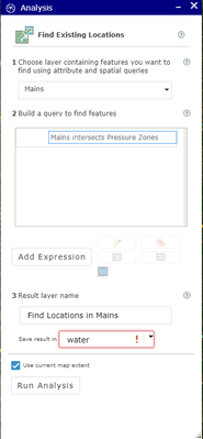

This is the panel looks like. The drop down arrow dose not work for  save result in so t tried to enter a folder name and got the warning.

Just to remind that the "Save result in" is a dropdown menu listing all the existing folders in your account. You can not name a new folder there.

Just a remind that the "Save result in" is a dropdown menu listing all the existing folders in your account. You can not name a new folder there. That's why you got the warning when you entering a folder name.
Also, we have stop maintenance for 10.6.1 which means we will deliver hot fix anymore for old version even a bug is confirmed. We suggest you to upgrade to 11.0 or newer if possible.
