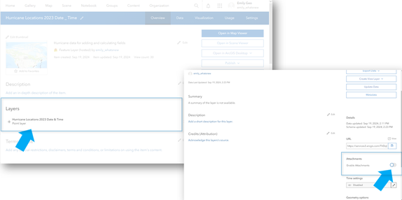

Hi @Laura_m_Conner
Yes, you can do that.
  • Open the item details page for the layer
  • Click to open the layer settings
  • toggle Enable attachments
  • the ability to add attachments will automagically appear on the form

TonyContreras_Frisco_TX
Not all items will support this method, but some hosted feature layers allow a workflow to enable attachments after the content has been published (if you are the owner or administrator).
See the Help page here.
