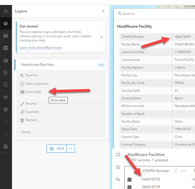

Is there a way to remove the thousands separators from the Data View on ArcGIS Online?
The way it used to work for me is that I would deselect the thousands separators option for the pop-up viewer in the Visualization tab and that configuration carried over to the Data view tab so the user would not see the separators there either. That workflow no longer works.
I checked the options available to configure fields under the Data tab, but there was nothing obvious (to me) there that would enable to remove the separators when viewing the data/attribute table.
I would like to remove the thousands separators from numeric columns that store years and numeric identification values when users view the data/attribute table.

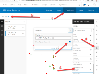

That is set in the Visualization Tab:
Which affects the table and the popups.
Need to make sure to hit the Save button in the upper left after making the change.

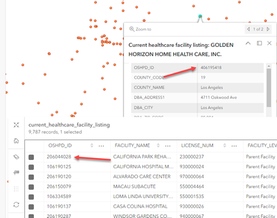

As I stated in my post. I already tried what you suggested. As an example, I made on of my feature layers (https://mtc.maps.arcgis.com/home/item.html?id=64fc40fc2ce641dfb65b44087ba4cb73) public so you can see.
When you open the Data tab, OSHPD Number has thousands separators in the values. When you click on a point in the Visualization tab, there are no thousands separators in the OSHPD Number on the pop-up as it was configured to not display them.
In my experience, the default setting for pop-ups is to not display the thousands separators. I had to configure the pop-up to allow them for columns where I wanted the separators. Thinking it could be a bug, I turned on separators for the OSHPD Number column, saved it, opened the configuration again, turned off the separators, and saved again. As you saw, the formatting is still mismatched between the Data and Visualization tabs.

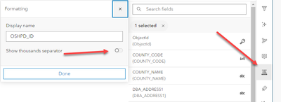

Went into Visualization tab, selected Fields button, and turned off the thousands separator:

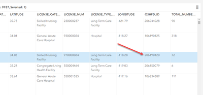

Data Tab:
Visualization tab, both table and popups:
All seem to honor the setting.

@RhettZufelt, I see the issue now. We are talking about different data tables. As you show in the images you provided, the data table that opens when clicking on the feature layer in the visualization honors the field changes made for the pop-up. The data table I am talking about is the Data tab that appears on the main hosted feature layer page, which has a header with Overview, Data, Visualization, Usage, and Settings.
In the past, changes made to thousands separator visibility and number of decimal places under the Visualization tab were also honored in the attribute table displayed using that top-level Data tab. Now it only changes what appears in the pop-up and the table opened under the Visualization tab.
