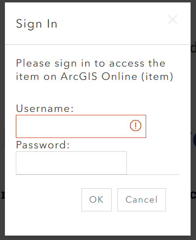

We created a map that had been working fine on a website.  However, I had to delete a user on our end and now it asks for a login like this on the website.  It works fine if you close out the pop-up but hoping someone has encountered this issue before.

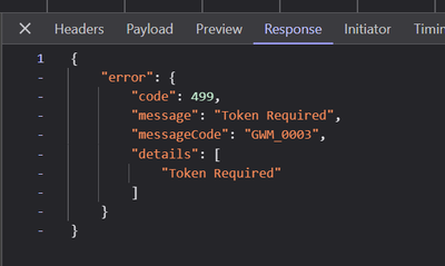

In the dev tools I found this response:
It's coming from this URL:
https://services1.arcgis.com/vdNDkVykv9vEWFX4/arcgis/rest/services/COVID19_Food_Access_(PUBLIC)/Feat...
Check the sharing on that layer, it doesn't appear to be public.
