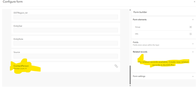

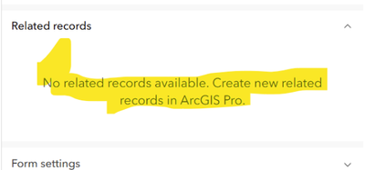

SaraWazir
Hi,
I am having the same exact problem that this thread has not been able to solve. Any updates on if this will be getting solved anytime soon?
I can see that I have related records and they show up in the popup but then I get this message (see attached) which says that I dont. How do I get around this?

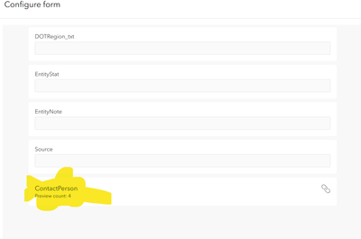

EmilyGeo
Hi @SaraWazir
This looks like it is working correctly. This message you highlighted on the screenshot on the right is an alert -it means you already put the related records element in the form, and there are no more to add.
The element highlighted on the left side if the screen indicates that you have placed the related records element on the bottom of the form.
That means the related records appear at the bottom of the form when you update an existing feature, like so:
