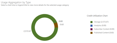

A bit of context from our org summary:
Thankfully we already use Views for the majority of feature services in our maps. I've just gone through and done some Change Log Trimming to see if that makes any difference of significance on the 3 largest feature services. I'm hoping it does!
We're also assessing what data we have in AGOL which may not be getting utilised enough to warrant the storage and removing where we can in full.
