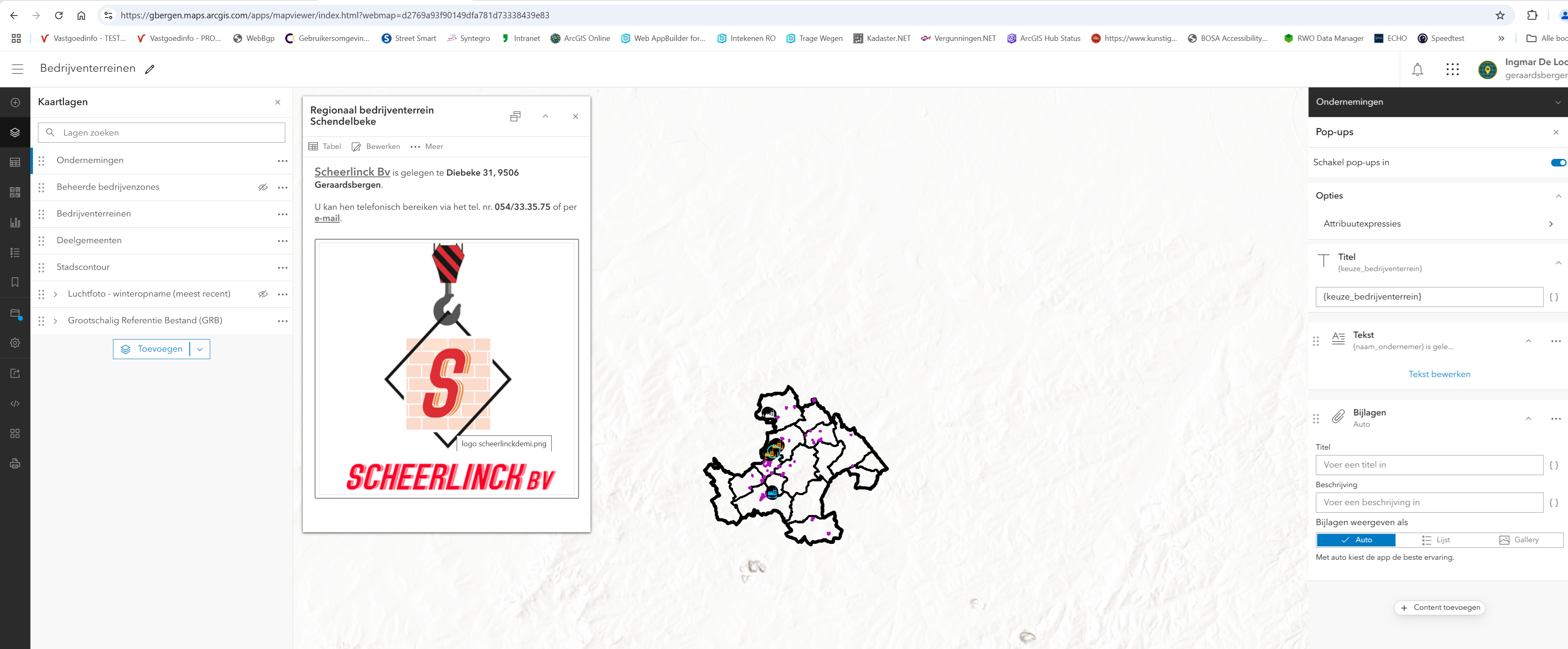

Hi,
I've created a Web Map which contains local company information derived from a Survey123-form. The companies logos are stored as attachments in the survey results_feature layer.
When someone clicks on an item and the pop-up shows up, currently they will see the company's logo (as an attachment). When they click on the logo, the logo will open up in full size, in a new window (and you can see the attachment URL in the browser's address bar).
However instead of doing this when people click on the logo, I would want them to be redirected to the company's website. The companies URL's are stored in another field, in the survey results_feature layer (labeled 'Website'). Currently they are redirected to the company's website, when they click on the company's name in the pop-up, but I would like this to be changed to the company's logo.
I was wondering if this can be done?
