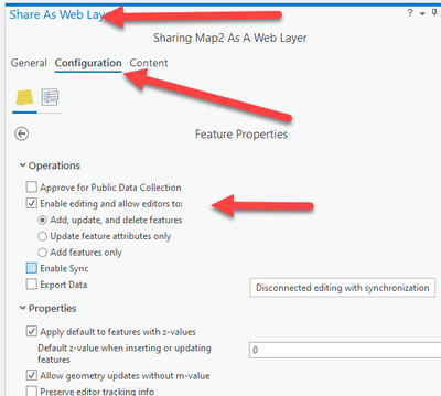

RhettZufelt
MVP Notable Contributor
That is set in the configuation when you share the layer from Pro:

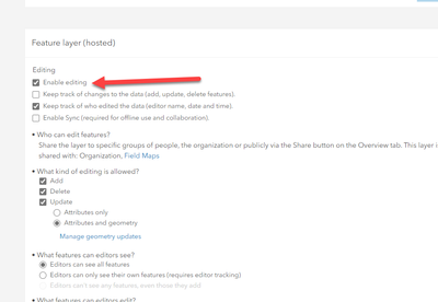

However, that can also be set in the setting tab for the HFL item details page.  Just be sure to save if you change it:
