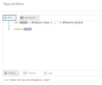

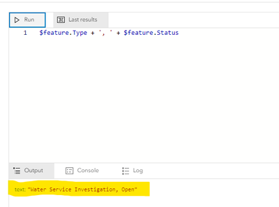

Henry_PeleshBW
Hi Josh,
Thank you for the reply. Are you saying that Arcade can't be used to symbolize by two string fields? This seems odd - it feels like my expression should be able to yield good results. I got the same error with the expression below.
@RussRoberts
Henry_PeleshBW
@RussRoberts
Sometimes all you need is to investigate a little deeper! (:
I got this to work properly using the script below. Just a simple change to establish a variable to return the results. Sorry for the bother!
