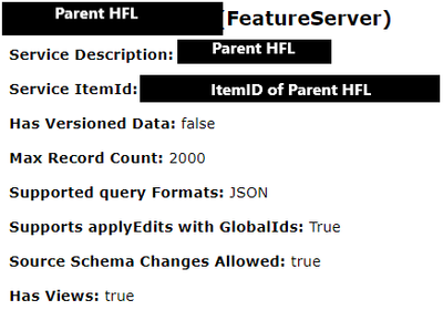

Feature Layer
This is where I get confused! This "feature layer" is tied to the parent HFL. So when the parent gets updated, this feature layer also gets updated. However I have no idea how this was created.

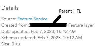

It just shows up as a "feature layer"
All that is found on the details pane is the following:
The only way I can tell that it's connected to the parent HFL (apart from seeing the updates) is checking the REST services directory for the item and seeing that it refers to the parent HFL.

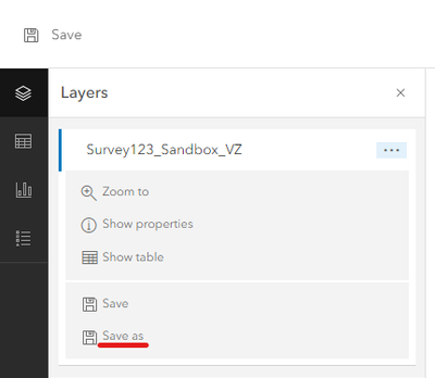

What does create the "feature layer" which links to the parent layer but is not a view layer, is the option available via the overflow menu (. . .) for the parent layer in question in either the visualization tab or a map viewer.
By clicking "Save As" in the overflow menu and following the prompts, the end result is a feature layer tied to the parent layer, and is very likely the same process that was used to create the layer in the question I initially posed.

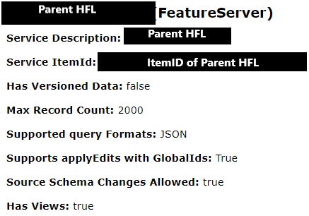

Following the steps in the link above, but without storing logins, results in a daisy-chain of original and second hosted feature layers, but with the same feature service.
Confirming that my testing gave the same behaviour observed by @Vince_ERAC - in the REST services directory (below)
