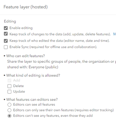

Even though I was logged on with the same account the entire time, going into settings and changing "What features can editors see?" to "No features", saving, and then resaving with "Editors can see all features" did the trick. I also edited the extent a few times, but I am pretty sure the setting switch and switchback did it.

I have the same problem in my project in Experience Builder (Developer Edition). In my opinion, your solution can solve it. But I can't found this parameters ("What features can editors see?"). Can I found this in profile of Portal or.. in wich place are these parameters?

@Nadia_Matsiuk It's under the Settings of a hosted feature layer's Item Details page, though this solution didn't work for me.

Update: Ah, it's not just turning it on and off. If you allow "Editors to see all features", switch over to edit your view, and then turn it back to "Editors can't see any features, even those they add" I was finally able to edit a view. Something about that blocks even you as the owner from seeing all the features so you can't even do the administrative task of setting up a view without making the private information completely public (it's a public facing Survey123 survey).
