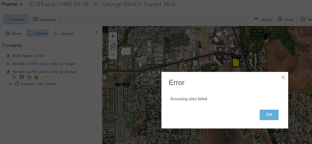

Hi Everyone,
I recently published three layers from ArcGIS Pro​ (1.3) to my ArcGIS Online​ account. The first two came in fine. But the third did not show up. When I tried to access the table from the third layer, it gave me the error message of "Accessing data failed".
The map in question is here: http://meiamerica.maps.arcgis.com/home/webmap/viewer.html?webmap=e97c0195b842460585a85ffa8a48b5d7
The 'funny' thing is, the data source for the second and third layer is exactly the same. Could this be my issue? I don't know why it would matter, but who knows...
Thanks in advance.
ChrisWhitmore
Adrian Welsh​ thanks for sending the sd file. Confirmed it's an issue with the field length. Unfortunately the only workaround really is to publish with shorter field names (32 characters or less) . This will be fixed on the Online side in the next release (currently planned for September). There also seems to be an issue with this in Pro with shortening the field names when publishing (essentially both Pro and Online should automatically truncate the longer field names but didn't in your specific case).
This info was sent over to the support analyst you talked to - they're writing these issues up, etc so you'll likely be hearing from them soon.

I think for some reason it is turned off...
When I checked it it showed in the legend.
EDIT: Scratch that..the table gives me an error too.  Have your checked whether there are any records being returned?

My guess is to look at the developer resource traffic (fiddler, etc).  I did test a query again the service, and it is returning data
http://services5.arcgis.com/mvnrDxfOCq0CsVom/arcgis/rest/services/10783_and_11442_SR18_St_George_Blv...
even if you say json.  I can't remember how to get it to spit out attributes off the top.  It does seem to have the goemetry sinc eyou can zoom to the extent too.  Head scratcher for me (but also didn't spend much time.)
Edit...I'm seeing an access error...if that helps any.

Adrian, the issue is that some of the field names in the layer are too long. Perpetual_Easement_65_value_estimate for example. Usually field names like this are transparently truncated (with the field alias maintained). Pro 1.3 should be doing this but doesn't seem to be in your case. Possible to share the SD file generated in my content when published from Pro? Can send to me @ [email protected] or share privately via group in AGOL (username cwwhitmore).
