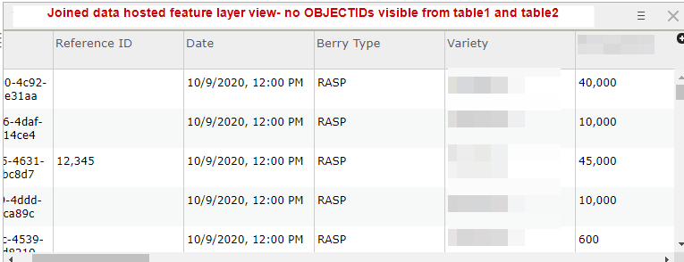

I have two hosted feature layers that I am combining in a join as a hosted feature layer view Each table (table1 and table 2) have their own object IDs obviously

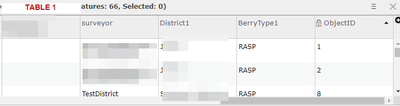

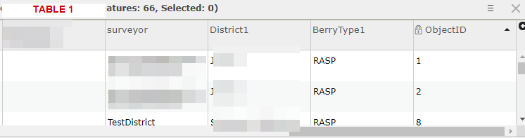

When I create a join between these two tables (based on global id/ parent global id), the resulting table does not keep the objectIDs from table 1 and table 2, though it does create a brand new OBJECTID that is not in anyway associated to the objectIDs in the other tables. I am wondering if there is a way to display the OBJECTIDs from Table1 and table 2 in this view so that we can reference the original table records when looking at this view?

If you want to include the ObjectIDs, I would suggest creating a new field (integer type) within each table and then calculating the field based on the ObjectID value. In the Calculate Field dialog, you would calculate the new field using Table1ObjectID = OBJECTID
