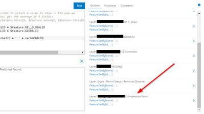

It appears that I can access the WebMap from expression builder for popups ...  I can see the 2nd Table in there but not sure how to access the attributes from it?
In the expression builder I can see the webmap that has the FC I am looking to query.
Here is the Table I want to query for a specific value ... if exists return true if not return false
How do I query it with Arcade Expression....

I think I can walk to the WebMap and Feature Class as such
     var relGlobalID = ($map,"Inspection Form FC")
BUT How do I query this Feature Class in the webmap looking for a specific value in the attribute field?
the attribute field name is relGlobalID
