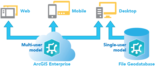

Hi Jacob,
A single-user model implementation of a utility network does not require ArcGIS Enterprise, however a multi-user model requires an ArcGIS Enterprise Portal with a federated server for serving a UNM service to multiple users:
 https://pro.arcgis.com/en/pro-app/latest/help/data/utility-network/what-is-a-utility-network-.htm
Full details for the requirements for a multi-user model UNM deployment are available here: https://pro.arcgis.com/en/pro-app/latest/help/data/utility-network/create-a-utility-network.htm
The management and configuration of a multiple-user model UNM deployment requires significant level of control over service capabilities/version management et al, as well as control over the UNM feature classes at the database-level
Unfortunately this isn't currently available in ArcGIS Online.

Hi Jacob,

Alex,
Thanks for all the information! It really helps clear things up for me. Just want to make sure I'm understanding fully though. So in the single-use model, it's not possible to publish any services (feature or image) even to AGOL. Is that correct?

Jacob,
If the service is being hosted in AGOL, you'd have a disconnect between your FGDB local copy and the hosted service, any updates done to the local copy won't be replicated in the hosted copy.   This is avoided in the enterprise portal/federated server model as you can have multiple services (a fully-featured UNM editor service, non-editable map and feature services etc) referencing the same enterprise geodatabase.
JacobRougeaux
I was under the assumption that it would result in a disconnect environment, so thanks for confirming that. It's good to know that it can at least be published unlike datasets containing geometric networks.
