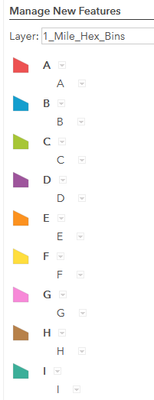

The closest thing you can get in AGOL is to define the editing templates as faux-subtypes.
  1. Base layer symbology on the "subtype" field.
  2. Open Manage Templates from the Edit tab in a map. By default, there should be a single feature type in each symbol group.
  3. Add new types to the symbol categories. In this way, you can limit the available templates to those with pre-defined options in some of their fields.
Unfortunately, this isn't the same as try subtype domains, but it's about the closest you'll get on AGOL.
