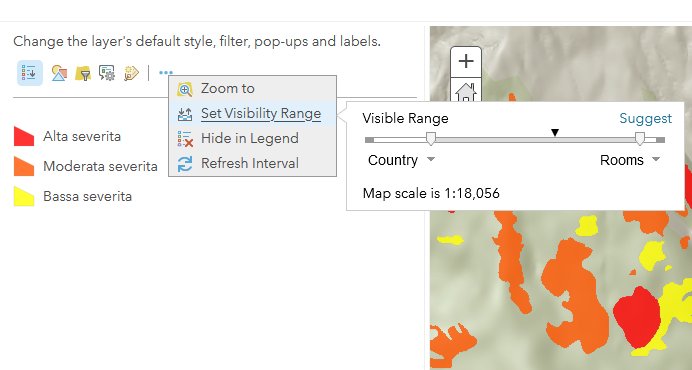

I have problems in a feature layer hosted visualization.
It does not respect the visible range.
Working from Visualization Tab I set a range wide enough. When zoom closer at the scale 1:18,056, I can see the polygons,

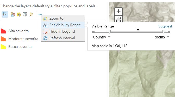

but when I zoom out (scale 1:36,112 or smaller) the polygons disappear:

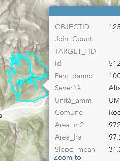

Zooming in and out, sometimes it happens that I can identify the Pop-up, even if the polygon is not visible:
