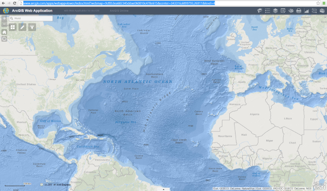

If I take your coordinate and apply them to a Web App provided in the Help, but apply a lower view level (4 in stead of 16) it becomes clear what is happening: ArcGIS Web Application
Change the basemap to oceans and you will see that the point is located somewhere in the Atlantic Ocean...
Are you sure that is the correct spatial reference (wkid) you are providing in the URL?

This spatial reference requires a transformation to get it on the right location. Not sure if and how this is implemented as parameter in the URL...
XanderBakker
Esri Esteemed Contributor
I loaded your service to a webmap, and configured the coordinate system using the coordinate widget (including a transformation), hoping this would solve the problem when specifying the URL, but it didn't.
Also tried to provide a fourth part (transformation number) to the center parameter of the URL, which change the location it centers at, but it does not seem to work.
I can only conclude that it is not implemented yet. Might be worth to request this enhancement or post it as idea:
