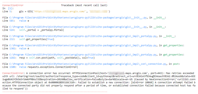

Thank you to the contributors on this thread.  I've got the script running in ArcGIS Pro toolbox but after 5-6 minutes I get a message;
"TimeoutError: [WinError 10060] A connection attempt failed because the connected party did not properly respond after a period of time, or established connection failed because connected host has failed to respond"
I am logged into ArcGIS Pro with my AGOL user account and I am testing the script using an item I "own" so it shouldn't be a security issue.
I've done some online research and a lot of people are suggesting it could be a firewall issue and I will need to alter my network settings.  I'd hate to get messing around with my firewall or network settings as our IT department would likely frown on that.
Anyone else encounter this issue?

lzk222
I've not encountered this problem. I'd try using a VPN and running this script. If you're already using one, try running it with the VPN turned off.

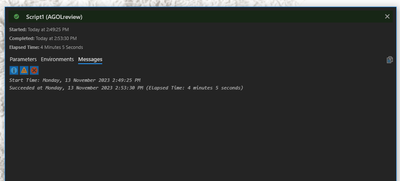

I am trying to run it as a script in an ArcPro toolbox similar to how @Katie_Clark had set it up in her previous post. It runs without errors but there is no output at the end. Im not very good with scripting so am unsure what Im missing.
Thanks again
