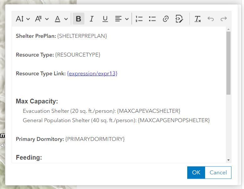

Here is what it looks like with 'no link' in the popup:
Here is what the Text box has:
