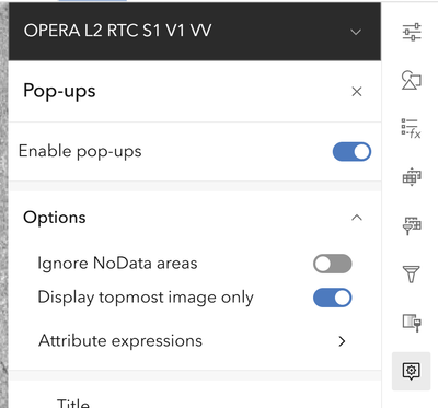

This issue is finally resolved!
PopUp_Ignore_NoData.pngIt came down to the "Ignore NoData areas" option in the PopUps menu for the image service layers.
If this setting is turned off, the pop-ups work just as well as they did in Map Viewer Classic. Apparently, the default for this setting in Classic was off, while the default in the new Map Viewer is to have it on.
I'm very relieved to have this sorted out, now that we can no longer use a Classic map as a workaround.
