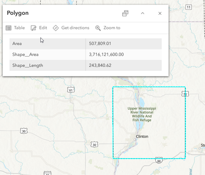

bbollin
@MK13 Can you provide more information? I can click a transparent /dashed outline polygon in the middle and the popup opens fine.

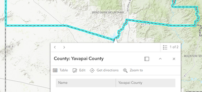

MK13
@bbollin Interesting! As you can see in my image below, the pop-up only opens when I click on the outline of the polygon and doesn't open when I click inside the polygon. May I ask if the dashed symbology that you have was published from Pro or set up in map viewer?
