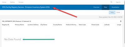

I'm not sure how you are getting it to draw in ANY map/app as there is no data to draw....
Perhaps the old maps had it cached or something?
