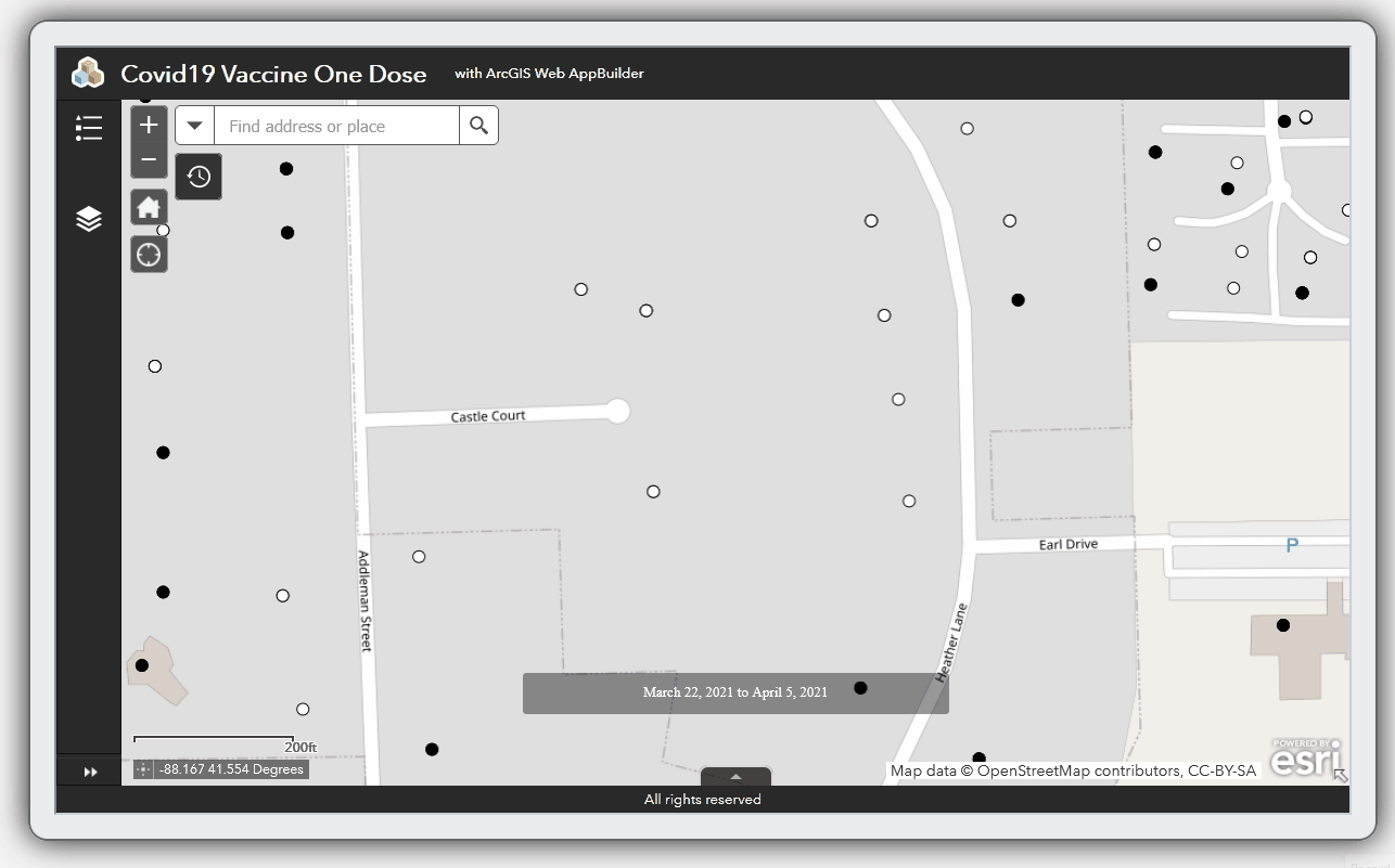

The whole dataset blinks when the time interval changes. How can I fix this?

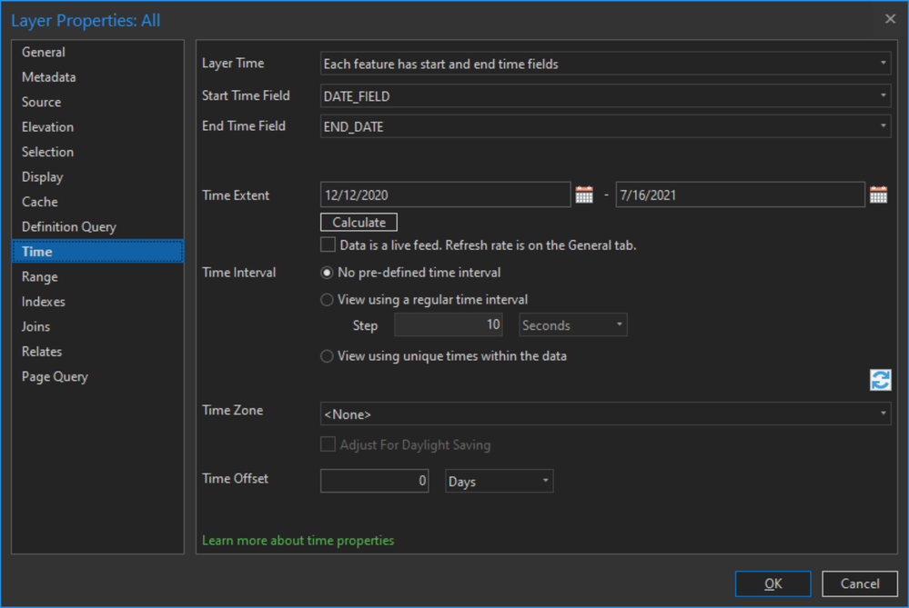

I have a point dataset that I've set up for time animation. I have the time interval set at two weeks (range of time is 8 months). And the symbol in the map is set on Unique Values for a field with more or less two different values (either 1 vaccine dose or two).
In Pro I have the following settings for the Time. The END_DATE field has null values. I did this to keep the points from visually resetting after each 2 week interval. The animation works fine in Pro.

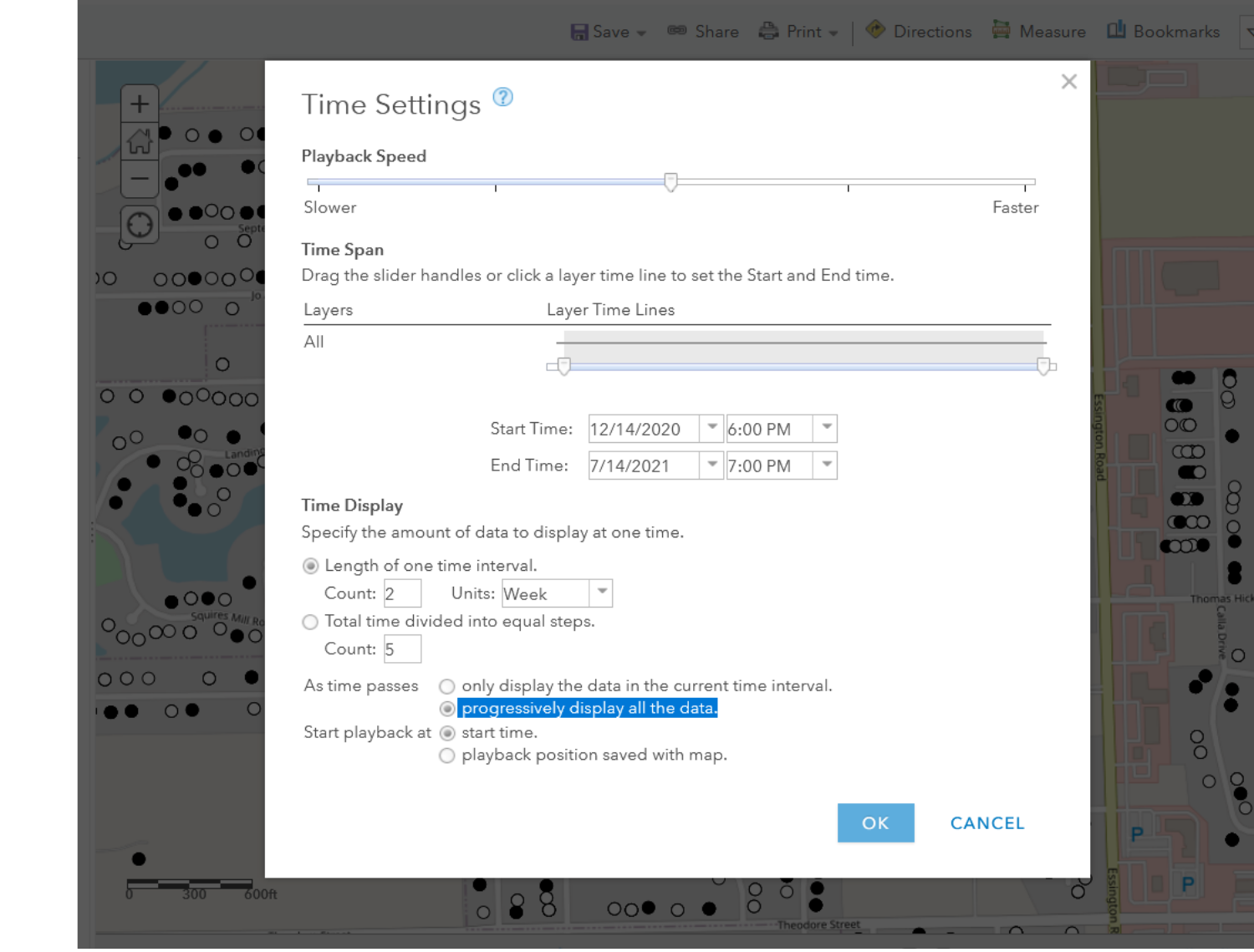

However, it blinks in AGOL. I have time animation setting set as such:

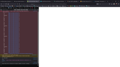

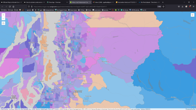

There's something wrong. I can't configure any new app. They don't finish getting created. But, it still ends up in my Content. If I select Configure it's a blank page. If I select View Application I get of view of Seattle for some reason (I'm in Illinois).
