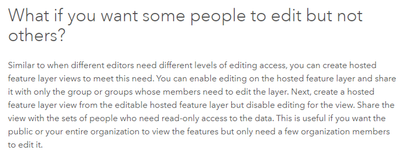

This storymap explains the Hosted Feature Layer Views beautifully. Please check Hosted Feature Layer Views - A Practical Example
Consider the questions in Data Access and Editing to determine whether you need to create hosted feature layer views, with whom you should share your hosted feature layers and hosted feature layer views, and which editing properties to set.
