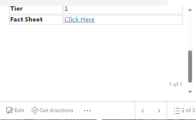

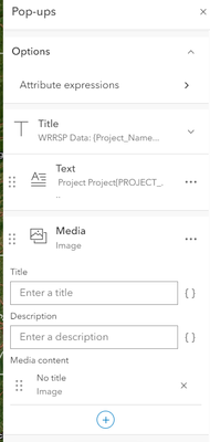

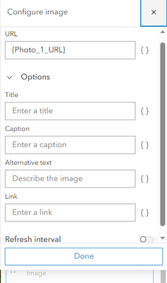

The HTML is only for the table. The images use the standard add images to pop-up on Map Viewer Settings, and again a few images will load into pop-up but most do not on the current Map Viewer wher.
Image of Popup View for Images and the bracketed URL:
These images all work perfectly fine in Map Viewer Classic but not the current Map Viewer and by extension Experience Builder due to it pulling from the Current Map Viewer for pop-ups and tables.
I've even removed the HTML code and reset the whole pop-up to just the title and photo link but the images still do not load into the pop-up so I still don't have a solution.
