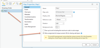

Also, be sure to check the Allow assignment....  box in Pro "before" you publish the service.  That way, overwriting the web layer will preserve the layer ID's and you won't have this problem.
