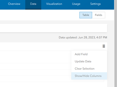

Hey Liam,
This might be a silly question but is the field deleted after doing this or is it set to hidden?
David

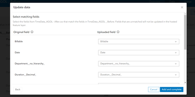

LiamHarrington-Missin
Thanks @David_McRitchie ,
Not a silly question as user error is very possible with me.  However, in this instance it definitely removes the field.  I go into the Overwrite with 11 fields and come out with 10.
I've provided two sample datasets and checked and the behaviour repeats itself.
Create a hosted feature service (table) with the before file, add an 11th field called Billable and then try and overwrite it with the After CSV.  Assuming you get the same behaviour as me, you'll see your newly created 11th field dissapears.
Liam
David_McRitchie
Hey Liam,
I just tested this and got the same behavior. I think it might just be confusing terminology as the overwrite operation should be overwriting the data rows, rather than the Data Schema. I believe this is a technical limit.
I would recommend using Update data in this case, and to remove any duplicated rows if these come up. Once the new Field has been added future Update operations should just add the data.
