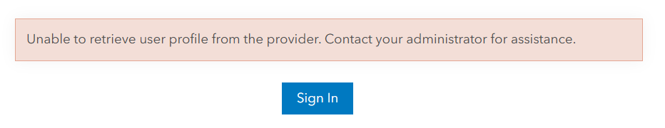

When updating the provider scopes to include groups, our login using OIDC breaks.
Results in:
I’ve tried many different values for the scope including groups[] and variations of it, but can’t get it correct.
Any idea what the scope syntax in AGOL should be or should we change the groups JSON format in Cognito to something different?
