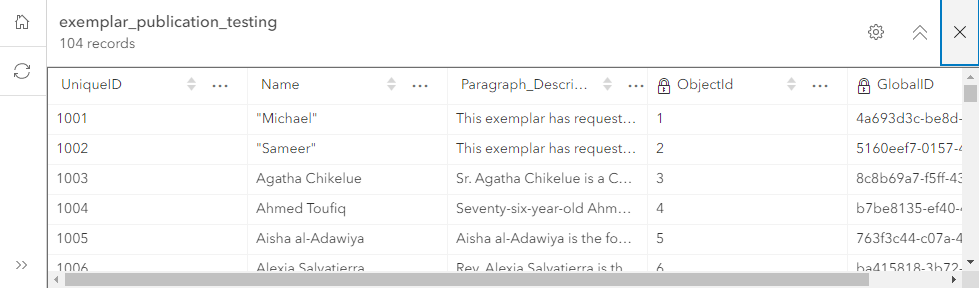

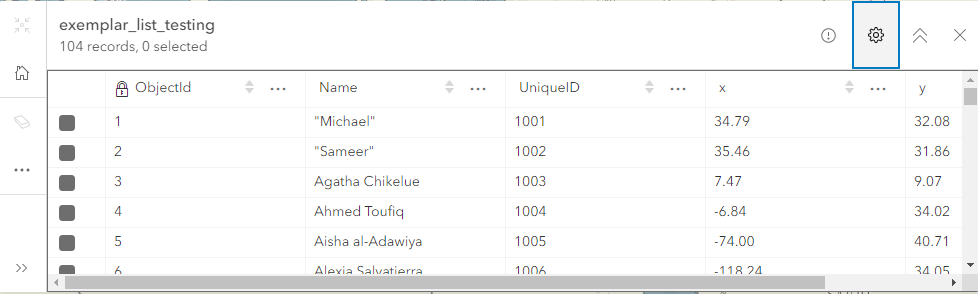

I'm having trouble figuring out how to retrieve a field from a standalone hosted table and show it in the pop-up of a hosted feature layer. Can anyone assist?
Data Item Overview:
exemplar_list_testing (hosted feature layer)
exemplar_publication_testing (hosted table)
I aim to display the 'paragraph_description' field in the feature layer pop-up from the hosted table.

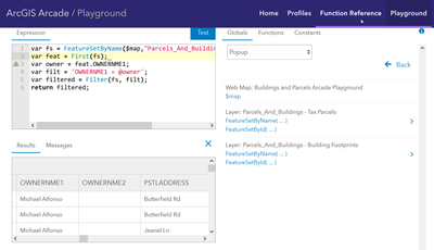

You can use variable substitution (see the Filter help) like that, shown here:

There is no ExemplarListID field in the exemplar_publication_testing table. Your sql expression should be
var ExemplarPublicationGID = "UniqueID = @ExemplarListID";
