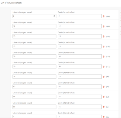

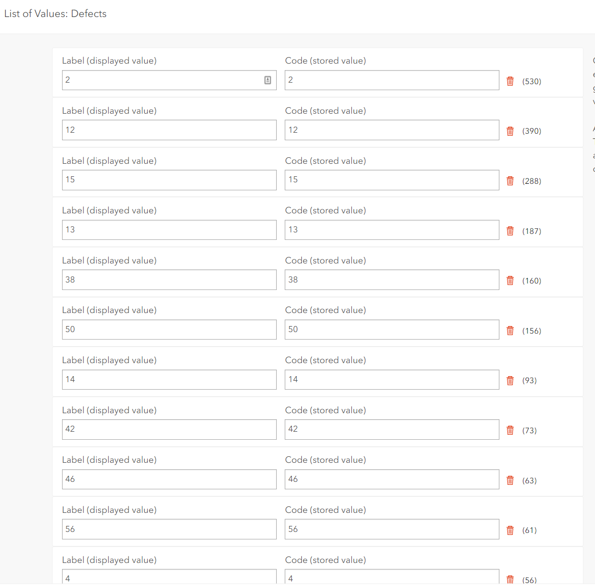

Recently we just completed a content migration to ArcGIS Online for this client.
However, some domain labels of one of the migrated hosted feature layers is not showing properly when using Generate List in ArcGIS Online. As shown below,  the labels of the domain are the same as the Code.

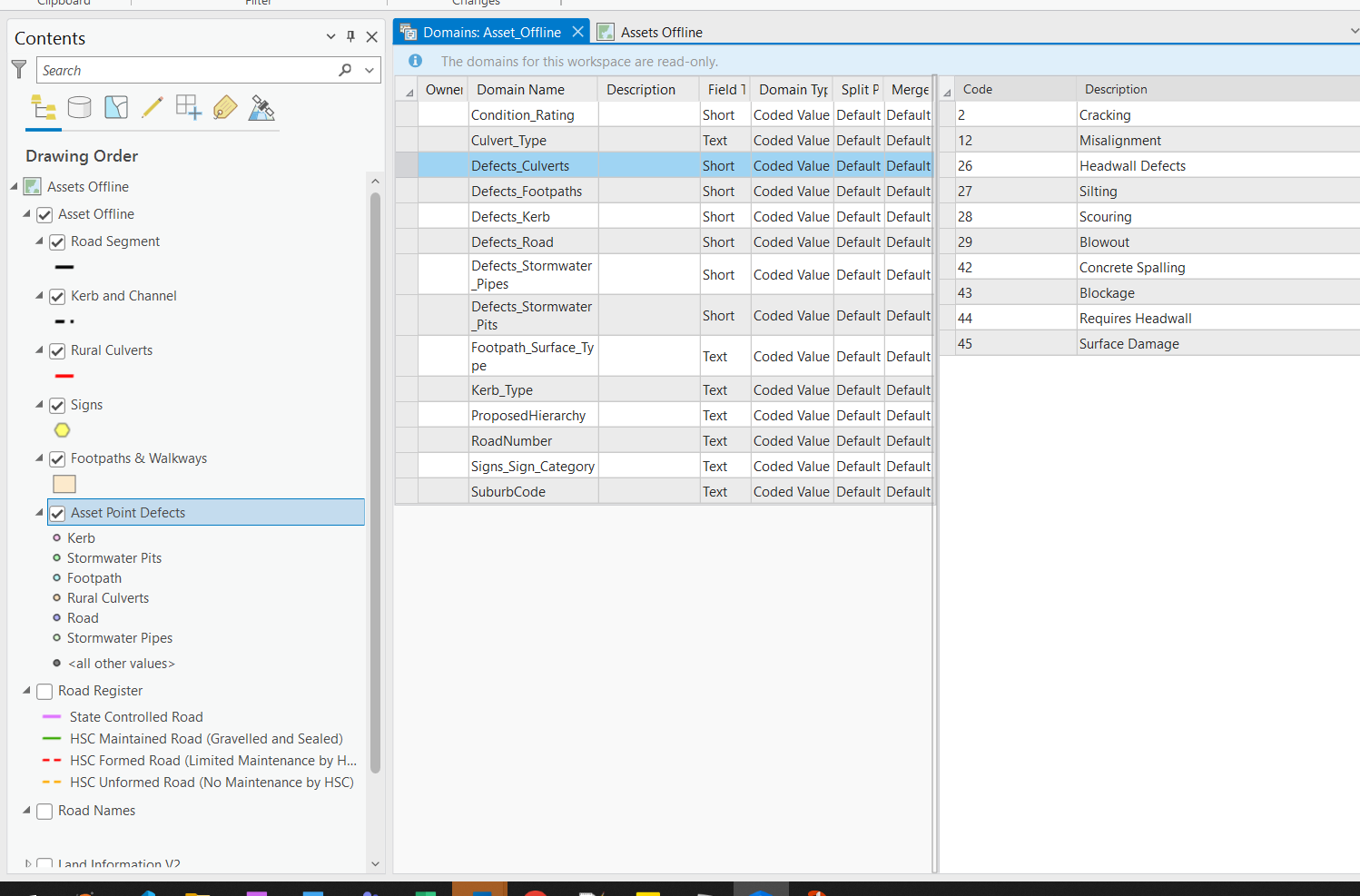

However, when the same hosted feature layer is open in ArcGIS Pro, the domain is showing the label properly under description. Can anyone explains to me what I might be missing here?

That is the way Generate list seems to work.  If you wanted different codes vs domains, you would need to edit them.

In your attached photo, are you sure that the "Asset Offline" data is the same Hosted feature layer loaded in through the portal link in Catalog and not a "local" feature class somewhere?  It appears as if you are showing domains for two different datasets.

Basically this is caused by different subsets of  the domain were assigned to another related field that has subtypes. Change in subtype selected in that field will change the domain values displayed. However, this is a limitation of AGOL to display this configuration properly as provided in:
