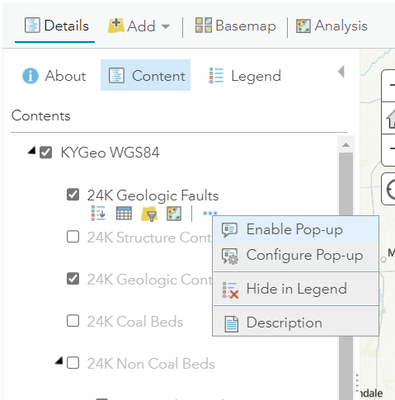

You need to enable pop-up at layer level (for desired layers). Click the three dots (...) under the layer name > Enable Pop-up. Then you may also configure pop-up, if required.

That was it!    Thank you so much!   I didn't even consider that as an option. 🙂

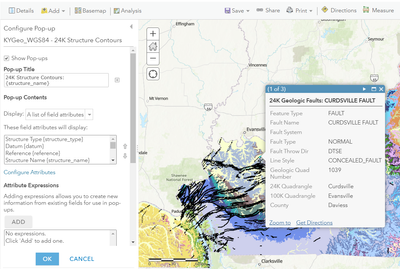

Ah ok - I actually thought this might be an issue with the new web map version. But I'll put my answer here for posterity... With the map viewer “classic” you can “Add a Layer from Web” and simply use the URL of the map service: https://kgs.uky.edu/arcgis/rest/services/KYGeo_WGS84/MapServer and that will add it to the web map (then enable popup, etc). I don’t see that option with the new web map viewer. So, I think you have to add that layer to your content by going back to My Content --> Add a New Item --> and select URL. Then use the URL above to add to you content. Then you should be able to bring it into your webmap by connecting to it in your content under the Add functionality in the new web map.

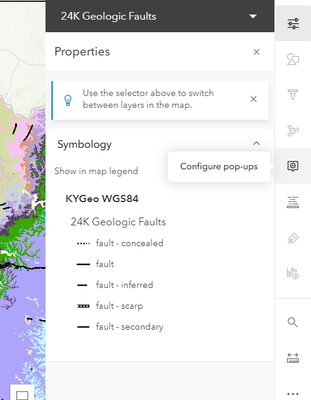

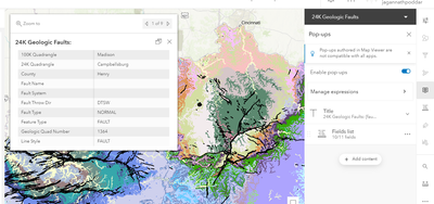

It's also possible in new Map Viewer. After adding the map service, expand to see the layer(s) > Click on the three dots (...) > Show Properties.
On the right-hand, you can see Configure Pop-up tool
On clicking it, you can see option to enable pop-up as well as configure it.
