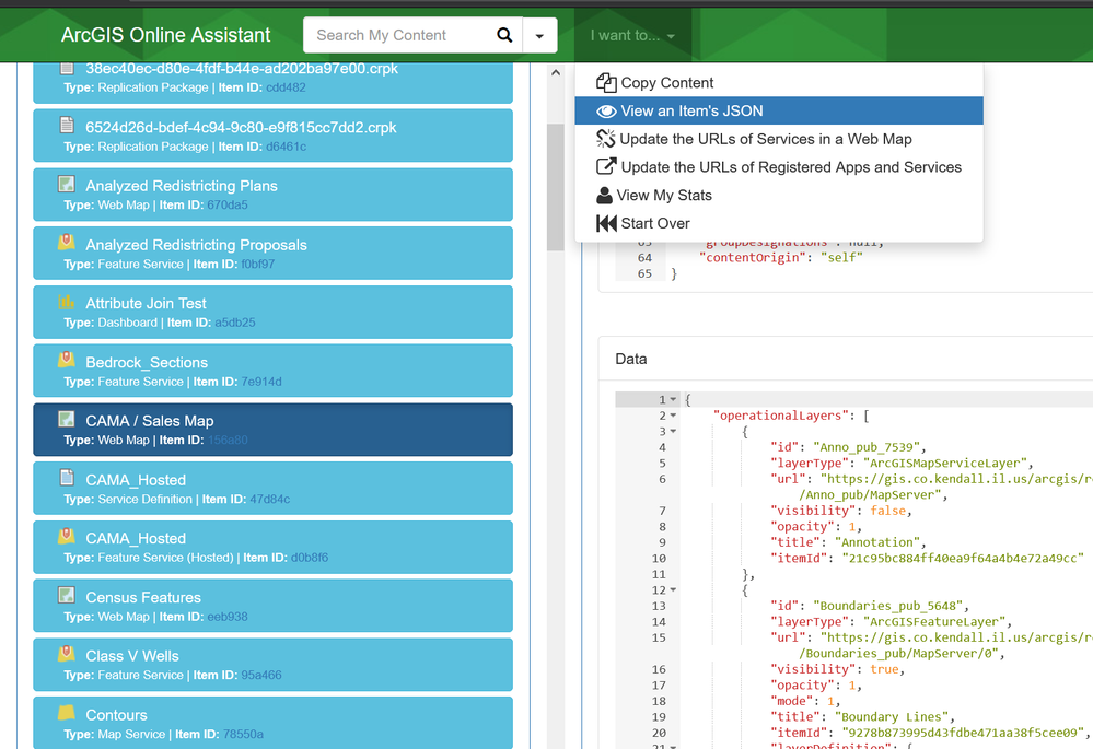

Check out AGO Assisstant. There you can choose "View an Item's JSON", and select the map(s) in question. Once you have the map's JSON loaded, you can look through the operationalLayers list to see where are the layers are coming from.
