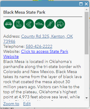

On computer,  it looks great with pop-up, the amenities showing inline

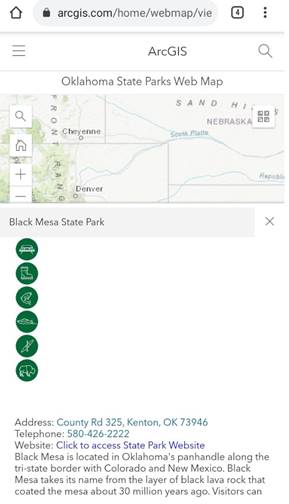

But on my Android phone, somehow, it came out vertical!!!  If anyone know how to fix this problem, please let me know.  Thank you and be well!

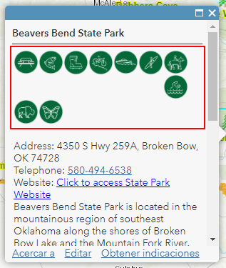

Although you mention that the pop-up works good when displayed on a desktop, it does not behave correctly in every situation. Have a look at "Beavers Bend" in the lower right corner:

Hello Dat,  I just wanted to reach and update you on your case, #02745608, regarding the pop-up window configurations in your web map. Unfortunately, it looks like this is a known limitation. I have tried to find a workaround, or way to edit the mobile browser configuration, but have had no luck at this time.
