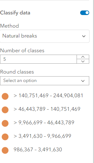

Choosing 1 numerical attribute provides the Counts and Amounts option, where you can select your classification method, number of classes, etc:

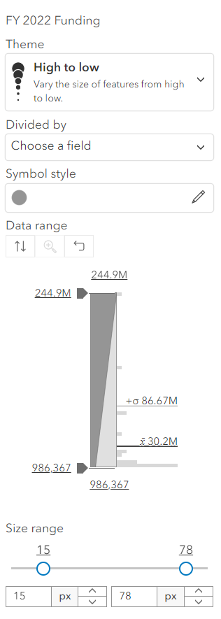

But when you add a second variable, there's suddenly no option to classify your data, and you're left with Esri's standard options: Types and Size. There are two menu items to customize each variable: Types (unique symbols) and Counts and Amounts (size). Unlike the Counts and Amounts menu available above, in this menu, there is no option to classify data: you must choose a "theme": Above, Below, or High to Low. You can set the high and low values, but nothing else.
2-Variable Counts and Amounts
Why is it suddenly impossible to classify data when using 2 variables?  Esri's "themes" don't provide enough control to tease out variability in the data the same way other classification methods do.

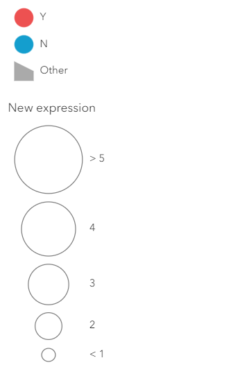

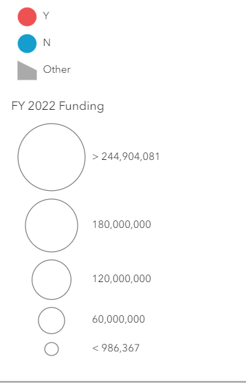

I tried using an expression and manually setting the circle sizes using the Natural Breaks values, which seemed to work alright at one zoom level, but the Legend displays the pixel size of the circle, not the actual numerical value, so it's basically worthless to a map viewer looking for that value:
jfischer91_6-1684176367776.png jfischer91_4-1684176118608.png  jfischer91_5-1684176143725.png
