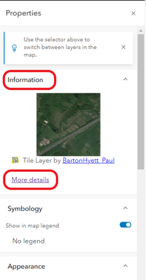

David_Brooks
MVP Regular Contributor
@JayJohnsonWashoeCounty  Here you go: Layer Properties > Information > More Details

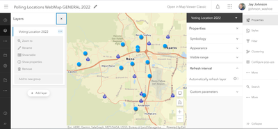

My Map Viewer doesn't seem to look like that?

David_Brooks
@JayJohnsonWashoeCounty that's very strange. I also tried it with a public dataset, and im definitely seeing that Information tab.  Have you tried some other layers?

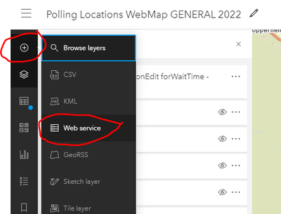

Okay, here goes...
If you add a layer to the New Map Viewer as a Web Service, you don't get the "Information" section as part of the "Properties".
And I don't see any way inside the New Map Viewer to see what the source of that layer is once you've added it.
Sure, AGOL Assistant is okay for that (but why should you have to leave the Viewer to get that info?).  You can also open the map in the Classic Viewer where the Information functionality still works regardless of how the layer was added.
Rather than just unhelpfully dropping the Information section for a layer added as a web service, ESRI should have left it, but given the user some message "Sorry, this is a web service and our shiny new Map Viewer doesn't know anything about it".
I guess the lesson here is to try to exclusively use Add Layer and to avoid using Add if possible.
