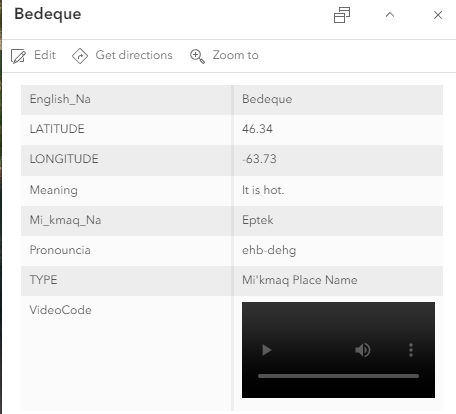

I figured it out! I put the <video> tag with all the needed info into a text field, added that field as text in popup configuration and it displays different videos in each popup. The only issue I found is AGOL would not let me paste the <video> tag into the table, I had to do it in ArcPro. Also make sure your text field that stores the URL is long enough or the html will get truncated, and the video won't work.
EMM03
Thanks for this!
This works great on my ArcGIS Pro desktop, but when I add this layer to ArcGIS online, the video no longer works in the pop-up (it's just a black screen). This is the code that I put into the text field of a table (which works perfectly on my desktop pop up). Any thoughts on what I'm doing wrong?
<video controls="" width="100%">
<source src="E:\MPN\Bayview.mp4" type="video/mp4">
Your browser does not support the video tag.
</video>
