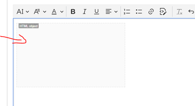

Thanks for this suggestion! I've done some testing and unfortunately it doesn't appear to be working with our videos. Our videos are hosted online and not attachments.
Here's what I have:
and here's what it looks like:

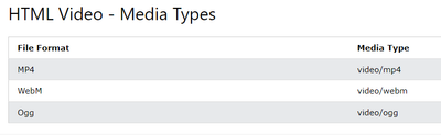

Unless I'm missing something, it appears that the <video> HTML tag only works with .mp4 file types and these others:
Any suggestions for web hosted videos?
