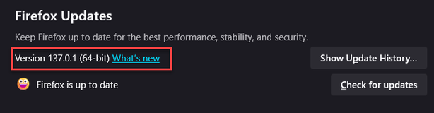

L77
Thank you for letting me know.
I am using firefix 137.0.1:

RussRoberts
Esri Notable Contributor
Map Viewer is using Calcite for our layer list which has the issue related to firefox and should have a fix rolling out with firefox 138. You can see the issue here with this sample when you set the property dragable to true https://developers.arcgis.com/calcite-design-system/components/list/
