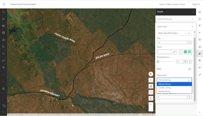

This is planned for the upcoming release of Online.
