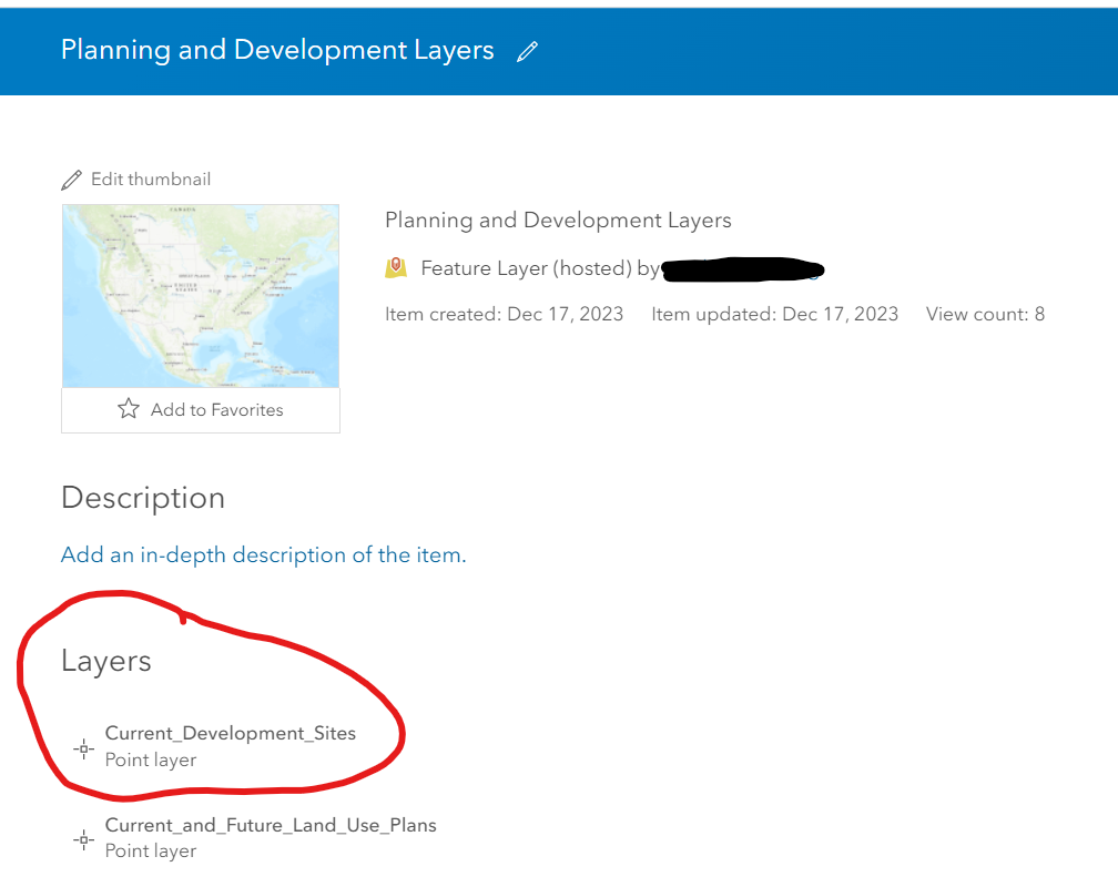

Hello,
I am trying to add layers to an already existing hosted feature layer and I'm not sure what I'm missing.
In the example I included, I am trying to add another new layer to the "Planning and Development Layers" feature layer. I cannot find a direct way of adding these.
What am I missing?
Thank you,
EmilyGeo
Hi @MikeDeDecker
If I understand correctly, you have a hosted feature service that contains one or more layers, and you’d like to add a third.
Adding a layer to an existing hosted feature service is not supported at this time, but you have options.
You could
  • publish a new service that contains all 3 of the layers you want, or
  • publish a separate new service with layer 3 and use it in conjunction with the original service that contains layers 1 and 2.
For more information on publishing hosted feature layers, the ArcGIS Online Help site is a great resource.
