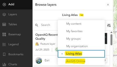

It would be good to confirm by changing the category to Living Atlas or ArcGIS Online. Do you see items listed when you change the Category from the drop-down?
