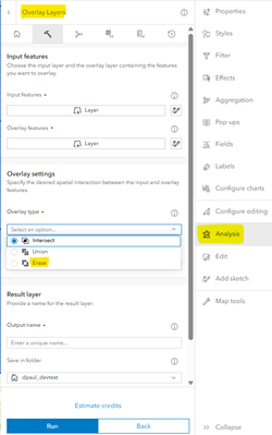

Hi @MohmdRauf , you can use Overlay Layers Analysis tool in ArcGIS Online Map Viewer and specify the Erase Overlay setting while running the tool.
Overlay Layers: https://doc.arcgis.com/en/arcgis-online/analyze/overlay-layers-mv.htm
Let me know if this helps!
To discuss more about the purchased subscription, you could reach out to a Customer Service Representative or a Technical Account Manager for your Organization.

Hi @JenniferBorlick , I've updated the link in my previous comment. Let me know if you face any issues accessing it!
If you are using the Overlay layers analysis tool in ArcGIS Online, it requires a Creator, Professional, or Professional Plus user type (Licensing requirements: https://doc.arcgis.com/en/arcgis-online/analyze/overlay-layers-mv.htm#ESRI_SECTION1_6BFA19468992455C...)
If you would like to use the Erase analysis tool in ArcGIS Pro, it requires an Advanced license. (https://pro.arcgis.com/en/pro-app/latest/tool-reference/analysis/erase.htm). And yes, the Professional Plus user type comes with an ArcGIS Pro Advanced license.
